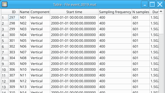

The minimal additional information to supply before using the signals inside Geopsy is the SamplingFrequency and a valid start time (even if it is fake). You can adjust the properties of the signals in several ways, but the most productive is through menu "Edit/Set headers" where a tiny script can do the job, for instance:

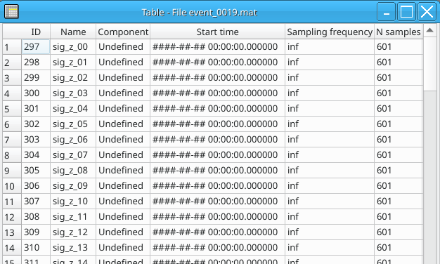

The signal properties right after importing the .mat file are show in the attached figure ("properties_0"). After running the above script, they are transformed and shown in the second figure ("properties_1").

You can store several matrices in a single .mat file. Only N x M matrices are considered. Higher order matrices are not considered. N is the number of sample in each trace. M is the number of channels. The name of the .mat variable appears as the SignalName.1. Can all the stations be in the same mat file or do I need to separate them?
Components are not identified automatically. The component of all channels is set to "Vertical" by default.2. Can all the components of the individual stations be in the same mat file?
for(i=0; i<signals.length; i++) {
signals[i].startTime="20000101";
signals[i].samplingFrequency=400;
switch(signals[i].name.substring(4,5)) {
case "r":
signals[i].component="East";
break;
case "t":
signals[i].component="North";
break;
case "z":
signals[i].component="Vertical";
break;
signals[i].name="N"+rightJustified(signals[i].name.substring(6,8)*1+1, 2, "0")
