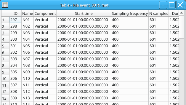

The signal properties right after importing the .mat file are show in the attached figure ("properties_0"). After running the above script, they are transformed and shown in the second figure ("properties_1").
(99.72 KiB) Not downloaded yet
(85.87 KiB) Not downloaded yet
