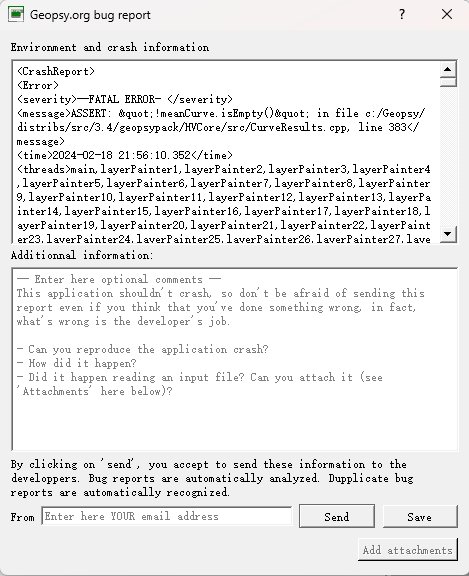

When I use the H/V tool, the software always crashes and I don't know how to solve it.
Attached is the information after the software crash.
Thank you.

Can you copy the text of the bug report rather a snapshot?

From the bug report, I can see that you are running version 3.4.2. Have you ever tried with 3.5.2?
I can also see that you have a huge amount of cores on your machine. If the bug persists with 3.5.2, you can try to run geopsy with a limited number of threads (8 for example). Inside GeopsyLand, run geopsy from the terminal
geopsy -j 8
