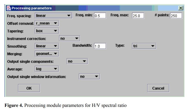

Reading the user manual of J SESAME I noticed that the program allowed to graphically represent the results referred to each single window. With Geopsy I don't think it's possible to do this, at least in a user friendly way.
Is this true or does this possibility exist?

No, this is not the problem and I think the two attached images can better explain my question.
I ask if it is possible to save the data of the single windows (as it was possible to do with J Sesame) and represent them graphically (J-Sesame1).

No this is not available in geopsy. It is always possible to calculate H/V and spectra for a single window, but you cannot browse the results with a single click. The various options for merging the horizontal components are available in the same way.

Is there a command that allows you to save the HV curves of all time windows?
