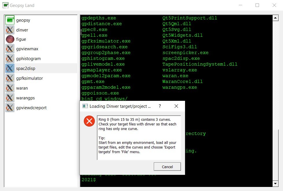

I processed a 9 stations, 3 components, 2D array with Spac.
When I open the target file with Spac2disp it warns me that there are 3 curves per ring and therefore I have to use Dinver to choose a curve per ring and then export the target file with File / Export Target.
I select the radial curves and then try to export with File / Export target, but unfortunately the program crashes.

I don't understand the meaning of the VRT option in post process with Spac2disp because spac2disp doesn't open reminding me that there are 3 curves per ring and that I have to choose one with Dinver.
