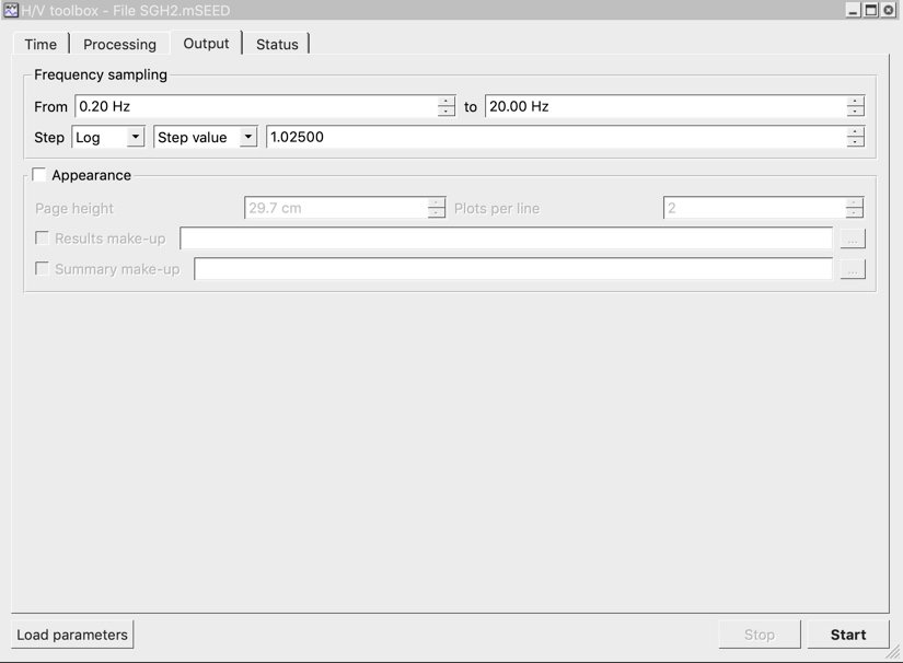

I installed latest version of geopsy and can't see standard output path option for HVSR results (image attached). What is the trick?
MacOs Mojave 10.14.6 and geopsy Version 3.3.0 (3.3.1)
Thank you,

Re: Output path not visible on MacOs
Hi Alex,
In the GUI, you can export results inside the result sheet. For Linux and Window, it is in the top menu, "Tools" if I remember well. On Mac, you have to right click anywhere on the sheet to get an equivalent of the top menus.
If you want to process more automatically, you can use geopsy-hv inside a terminal.
