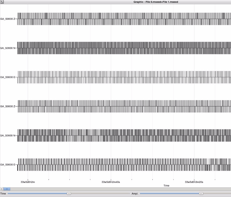

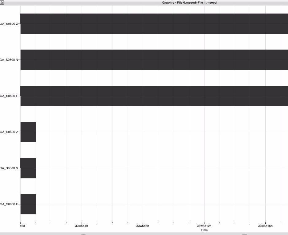

The main problem is that in all cases (using GUI or script) the export to miniseed doesnt work. The resulting files are just some kind of saw noise.
I use following script to test:

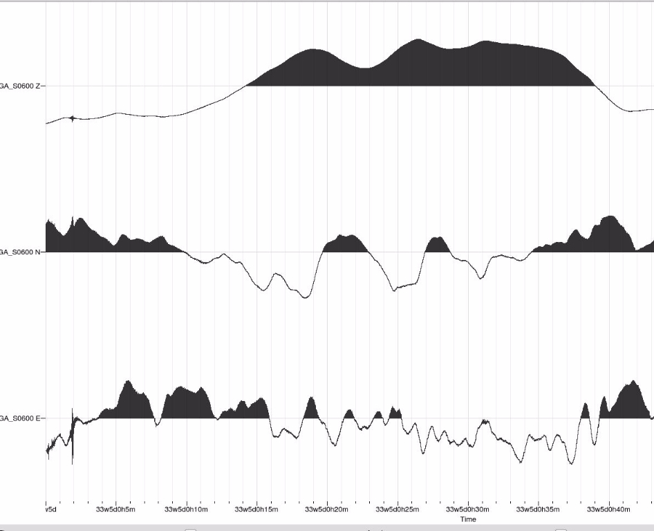

I attach the images :
1-GUI-mseed.jpg - snapshot of results using GUI
2-mseed_script.jpg - snapshot of results using script (top 3 traces) and exported to miniseed from GUI (bottom 3 traces)
3-zoom-mseed_script.jpg - same as previous but zoomed
