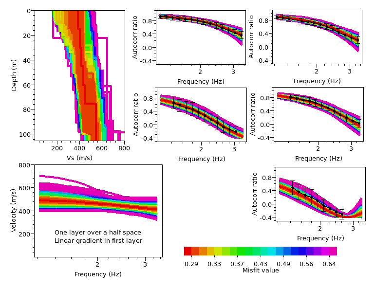

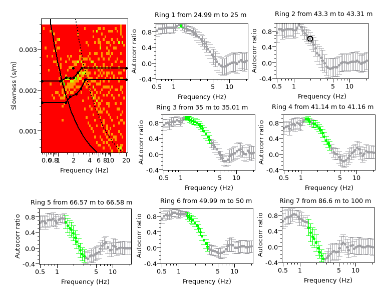

I analyzed the three arrays at the same time (possible only with the next release):
I discovered that your spac curves are not sampled the same way. To process them in spac2disp, you must have the same sampling (option of the processing). In this case, I cut and resampled the curve between 0.5 and 20 Hz, with 50 samples in log (using Dinver, now export of target is working properly, next release).
A single target file is saved from Dinver and in spac2disp, all rings match a single dispersion curve between 1.5 and 3.5 Hz, except the first two rings measured on the smallest array. I suspect that the reduced number of station pairs (3) for this array leads to slightly biased results. I discarded those two rings after loading the selected target in Dinver.
When you load the target file into dinver, the empty rings are still there. Don't forget to remove those two rings. I used a very simple model for the inversion and got finally very good misfits.
All rings are well fitted except the last one. The frequency band is not different from other rings so the misfit cannot be improved by adding more degrees of freedom. This probably due to particular ground configurations or noise structure viewed by the larger ring.

spac2disp ARRAY_A.target SPAC_B.target SPAC_C.targetA single target file is saved from Dinver and in spac2disp, all rings match a single dispersion curve between 1.5 and 3.5 Hz, except the first two rings measured on the smallest array. I suspect that the reduced number of station pairs (3) for this array leads to slightly biased results. I discarded those two rings after loading the selected target in Dinver.
It would probably help understanding this structure if you have H/V ratio. The depth of investigation is difficult to estimate because the dispersion is almost flat. From the wavelength criteria, I would say that we have information down to 100-150 m (1/3 of lambda). The maximum depth was fixed to 100 m so all information below is not valid.
What can be learned from this inversion probably that you need lower frequency information (to be confirmed by H/V results).
- Spac results, first two ring are not selected
- (49.07 KiB) Downloaded 561 times
- Inversion of spac results with a very simple model (too simple?)
- (56.11 KiB) Downloaded 578 times

I checked your target with spac2disp and in fact the selection is probably too large. The first two rings have a dispersion curve far from the one from all other rings (local structures close to surface not viewed by larger wavelengths?). Your high misfit comes from the fact that it is no possible to find a single dispersion curve explaining all autocorrelation curves. When you run the inversion with all 7 rings the solution found falls inside the distribution of models shown in the figure above. Still, a small contrast is visible (from 350 to 500 m/s).
The only way to decrease the misfit is to discard some points or entire rings from the inversion. But at the end it won't change drastically the Vs profiles. I think that the best to do now is to process H/V in the area and decide whether you need larger arrays or not.
