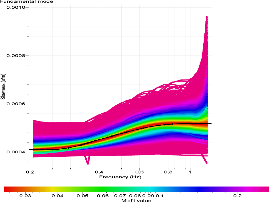

I fixed the deepest layer (DVs2) to 10km, though when I plot the ground profiles (View -> ground profiles) the depth on the y-axis sometimes doesn't go all the way down to 10km. Is this because the program only plots velocity that varies? If the velocity doesn't change after a certain depth (i.e. profile goes straight) it's not included in the plot?

dispersion run1
(119.08 KiB) Not downloaded yet
dispersion run2
(123.29 KiB) Not downloaded yet

dispersion run3
(124.14 KiB) Not downloaded yet

Looking at your figures, there is something wrong but can't find what it is. Can you save the dinver environment (File/Save as) and send me the .dinver file. *_report directory is no required.

Re: Defining Parameters in Dinver (Parameterization)
Having a look at your dinver file, I finally got your question, sorry for the delay:
The answer is simply yes. The y axis is adjusted to the deepest velocity change plus a small percentage (cannot remember how much exactly). If you want to plot things down to 10 km you can adjust the y-axis range using the properties (context menu or double click on the graph).
