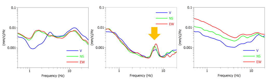

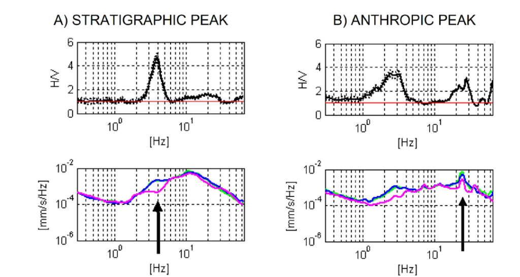

How can I make a spectral analysis for each component to judge if the resulting frequency is the resonance frequency or not as shown in the attached images?

Sorry for the missing images, could you please have a look at the attached images?

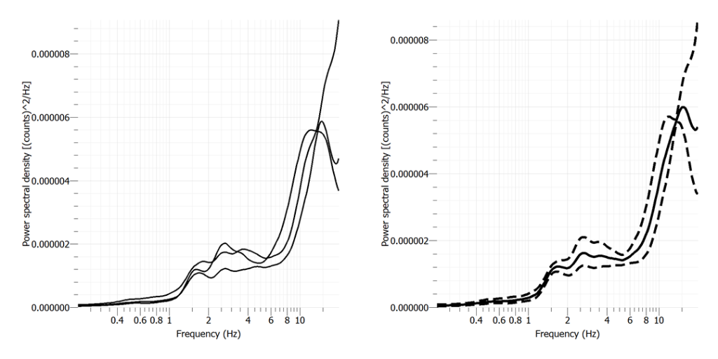

I tried the spectrum tool which is provided in the same plugin library of H/V, as shown in (Geopsy spectrum image) the units were different than the (Example 1 and Example 2 images), moreover, it's not clear in (Geopsy spectrum image) that each line in the graph related to which component.

The units depends upon the unit of the signals. By default, the signals have no unit ("count"). If the conversion factor "count2volt" is different from 1, the signal are shown in volt. The same applies to "volt2unit". These values can be set for each signal in a table (direct editing after unlocking edition in menu "Edit") or with menu "Edit/Set header".
To change the line types, right-click on the plot and select "Properties". Inside "Layers" tab, change the legend, put your own style to distinguish the lines. The order is the same as in the sheet with the individual results.

when I use the spectrum analysis tool, it calculates and presents a graph that shows the unit "(counts^2)/Hz" on the Y-axis, and that is not the required output in my situation, what I need for the Y-axis to represent is the unit "(mm/s)/Hz" but I still have some difficulty doing exactly that.
it should be noted that the X-axis represents the unit I need, and I don't plan on changing it.

If CountPerVolt and VoltPerUnit fields have a value of 1, signal units are assumed to be Counts. If you want to plot your spectra in mm/s, you have to change the values of these fields with menu Edit/Set header. For example you can use these scripts.
If your signals are originally in Count (adjust the correction factors):
for(i=0; i<signals.length; i++) {
  signals[i].countPerVolt=10000
  signals[i].voltPerUnit=2000
  signals[i].amplitudeUnit="Velocity"
If your signals are already in m/s but Geopsy does not know it, use this trick:
  signals[i].countPerVolt=0.5
The amplitude of the signal is not affected. Geopsy uses only m/s for Velocity. You have to edit the Y axis of your results to set them to (mm/s)^2/Hz. This is valid only if the original signals are in mm/s. Note the square because this is a spectrum power. The spectrum amplitude would be in mm/s/sqrt(Hz).
