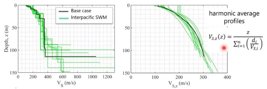

Now, what I want is Vs (average) profile up to bedrock depth, i.e., I wish that a profile with Vs (average) values sampled at each 1 m depth, up to the bedrock/ up to whatever depth we want. How can we get that? I request you to add some command to calculate it.
I have attached a figure explaining the Vs (average) profile.

If I correctly understood your request, this is implemented with option -average-depths
gpdcreport -best 100 my.report | gprofile -average-depths > out.txt
