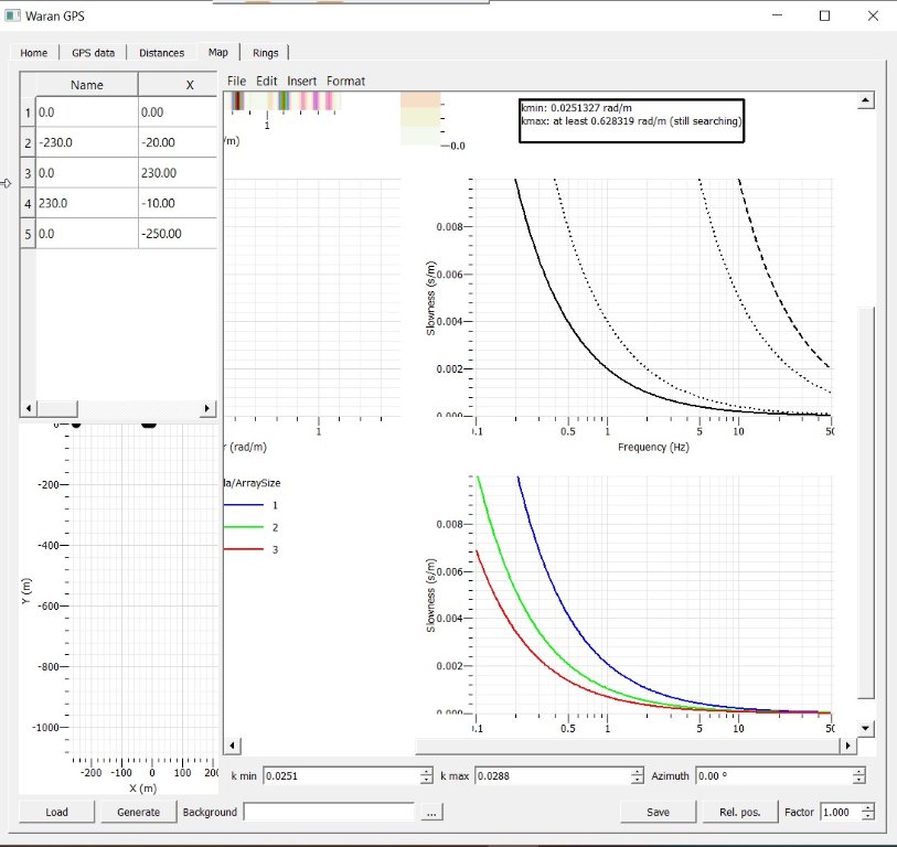

Sorry, I forgot your suggestion to use warangs.
I did it and I send you the image of the dispersion curves, station coordinates and the values ​​of kmin and kmx.
I hope to have rightly understod your suggestion

I'm fine with your spac curve and the selection you did in spac2disp. Just make sure that kmin does not correspond to wavelength too large compared to your array aperture. Roughly speaking, your array has a 500 m aperture. A kmin of 0.0015 corresponds to a wavelength of 4189 m (lambda=2*pi/k) which is more than 8 times the array aperture. Usually SPAC can get reliable results down to wavelength 2-3 times the array aperture. Some authors even claim for 6 to 7 times but to stay on the safe side and without other information it is better to limits the autocorr curve at low frequency. So I would limit kmin to 0.005 (wavelength of 1250 m)
