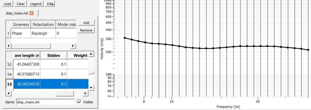

manually applying a standard deviation of 10% to a dispersion curve I get a bar that seems absolutely incorrect to me. What could be the problem? I recently installed windows 11....is that going to be it? Is there a way to fix it (even increasing the number of decimals nothing happens)?
anomalous Standard Deviation

Re: anomalous Standard Deviation
Try to set it manually to 1.1. Is it better?
with 1.1 is fine. Till present I had always successfully used 0.1.
Is there a reason for this?
Was it with 3.4.2? With older releases the uncertainty where not processed the same way and it is possible that 0.1 was fine.
Of course,3.4.2, that's why I was surprised both that 0.1, which always worked, was no longer correct, and that 1.1 gave the right result, overnight.

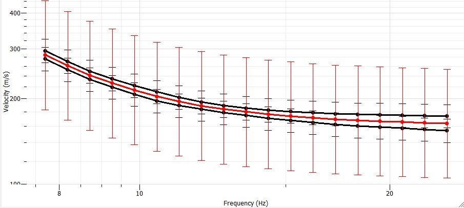

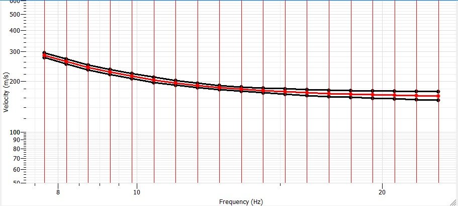

I have tested previous dispersion curves that correctly represented 10% with 0.1 and found that they all now have the anomaly of representing 10% with 1.1.
Previously I had recorded that the mean curve automatically provided absurd standard deviation bars, equal to the ones I now obtain by applying an SD of 0.1 (the two curves to be averaged have no SD, see attached jpg).
If I apply an SD of 10% with 1.1 to the two curves, I obtain an average curve with an SD that is >30%. Is it wrong or am I wrong (see the jpg STD_average_1)?
