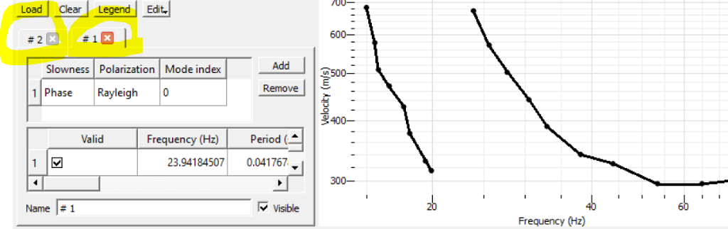

I am kind of new to the Geopsy and dinver. While I am still trying, I faced an issue. This is the dispersion that I got from the geopsy:
I have problem removing the line between the points that the mode changes ( line between points on the x value of 20 and 25)! if I remove points, the line attaches to the next point. The idea that i came up was saving different files for different modes and load them in dinver separately. in this case, we have different tabs for our dispersion curves and I am not sure if the inversion understands it correctly ( i do not want to have two tabs--they are highlighted with yellow)?
( i should say that i saw someone using dinver and they had all the modes in one tab without lines attaching different modes together--However I cannot mimic that)
