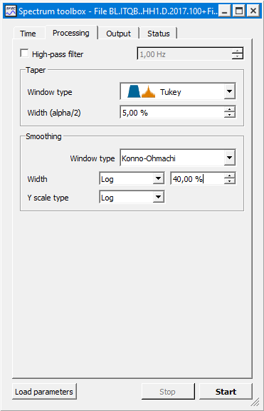

Re: Problem: Sharp peaks and industrial origin
Your spectra look very smooth. Can you post a screenshot of the smoothing parameters in the spectrum toolbox?
Usually peaks from machinery are very localized in frequency. Unless smoothing is too strong, your spectra do not look like being affected by a clear artificial source.

Hello, thank you very much for your help.
I attach the images corresponding to the smoothing parameters and also different variations of it (5%, 10%, 20% and 40%).
