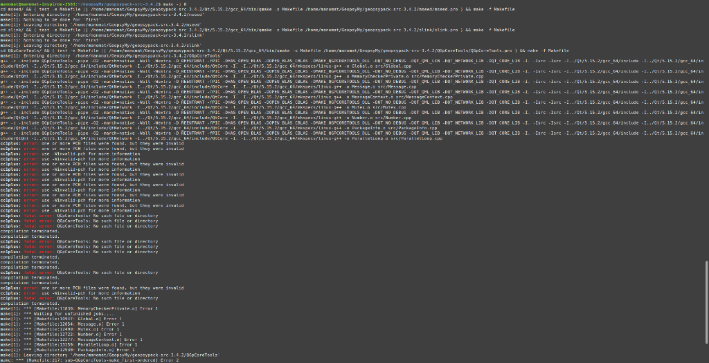

Hello everyone,
I'm using Linux Mint 20.2 and try to install geopsy. After successful troubleshooting Qt libraries and geopsy version conflict (warning about older Qt version), I'm trying to install geopsy v3.4.2, but I receive the following errors, as depicted bellow in the attached image.
Any ideas how to solve it? Should I check and re-install the prerequisites ?

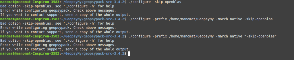

Hi Manos,
You can add "-skip-openblas" in the configure command line.
Some processes might be sub-optimal with this option but you will solve your compilation error.

Hello, thanks for your reply!
When I add the "-skip-openblas" command you mentioned, the following message appears.
The "-skip" command is not recognized, and as far as I can tell, I should add something like "--ignore-errors" and/or "--keep-going". Any thoughts on how to proceed?
Sorry for asking something that might be obvious and trivial, but while trying to configure Qt libraries, I ended up installing Linux again. Twice.

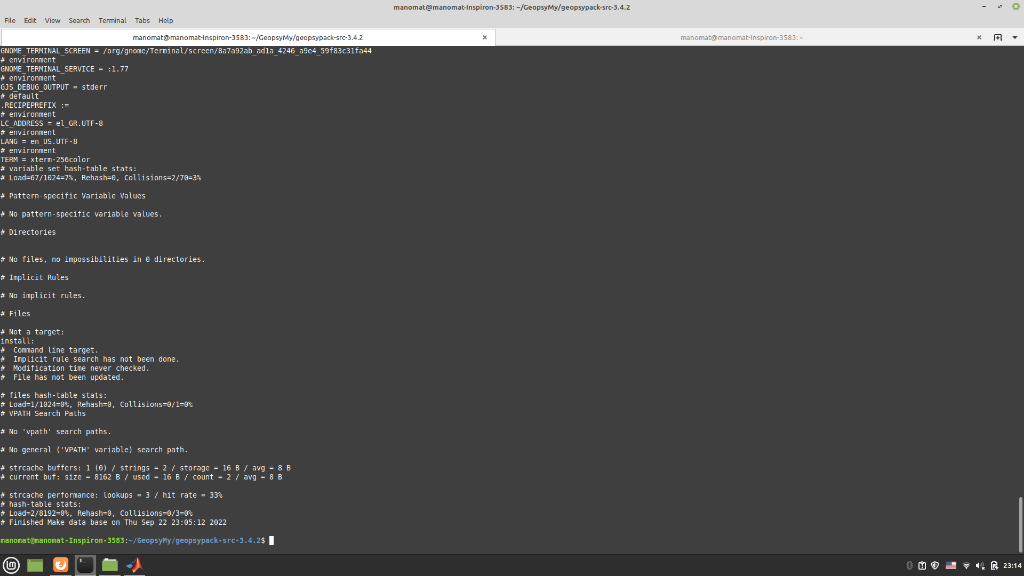

Hi Manos,
You have to add the option "-skip-openblas" to the configure step. In your snapshot, you added it the make step. A single "-" not a double is required.

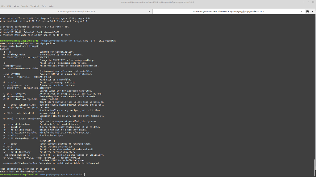

Well, I tried both, single "-" and double "--", I just put the screenshot from the latter.
When adding "-skip-openblas" option to make command, then after the options list shown above, I got all these extra #environment information, and also some more.
Does this means I'm OK with installation?
Greetings,

No, you are not done.
You cannot add this option to the make command. It is not recognized as a make option. You have to add it to the configure command one step before the make command.

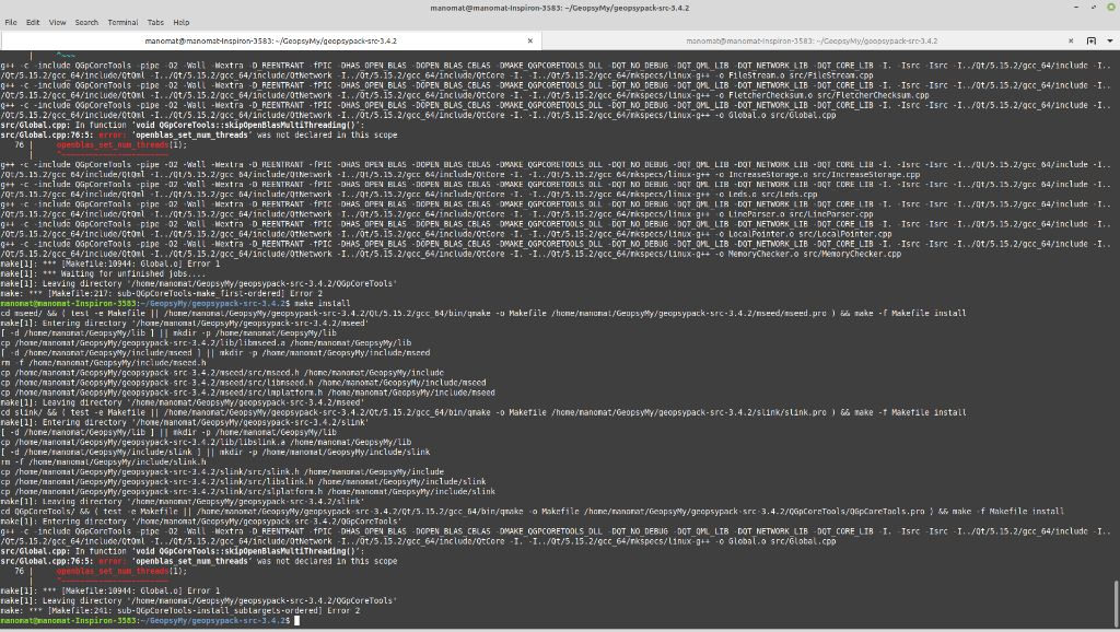

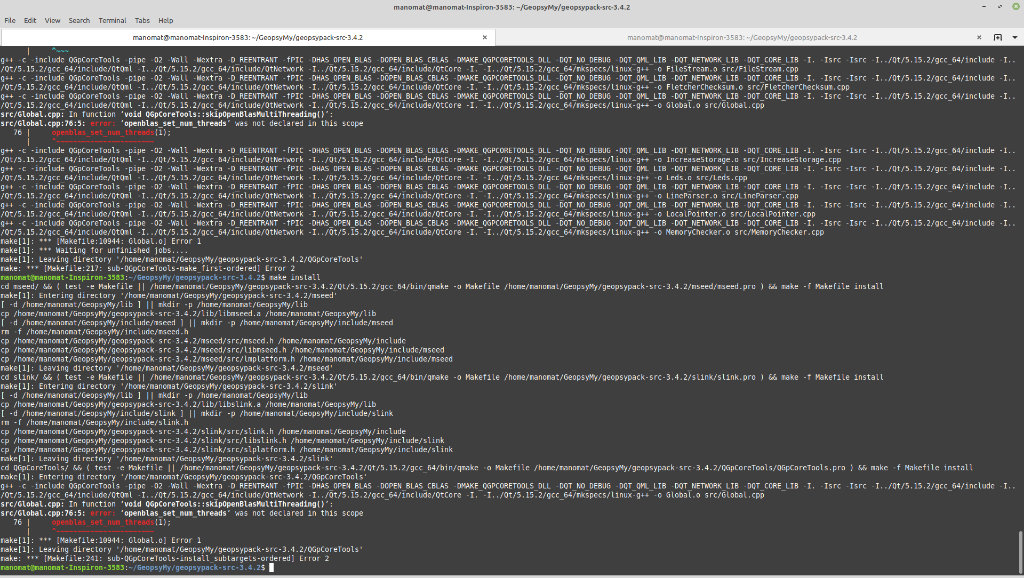

Hi Marc, and thank you for answering immediately. I appreciate that.
Yes, my mistake: I should have add "-skip-openblas" to configure command and not at make.
But is not recognized as an option for configure as well. Attached you may see the "Bad option.." message I get.
Nevertheless, I also apt install "libopenblas-dev" package again, so now I'm trying commands configure (without adding "-skip-openblas"), make and make install. Then I receive more error and fatal error messages, as seen in attached figure.
Following the troubleshooting of that post, I also tried make -i in order to ignore the errors. Then the installation process takes a bit longer, with many more errors and fatal errors coming out. I can tell that there is no space left on the partition.

Hi Manos,
Try to run
before running the usual
The change you made to OpenBlas library requires the update of pre-compiled headers.
When you send terminal errors, copy and submit the text (e.g. inside <code> </code> tags) rather than a snapshot.
Try to run
make clean
make
