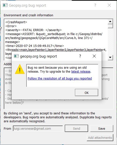

I have verified that with version 3.3.1. of Geopsy it is not possible to use the Spac2disp tool because the program crashes. The bug report is not transmissible because a message appears saying that I am not using the last version of the program. This is not true because 3.3.1. is the latest release currently available. So I can only see the autocorrelation ratio graphs with Dinver for the different radii, but I can't to save the final autocorrelation ratio curve as shown in technical documentation.
Is it possible to verify the nature of the bug? I attach an image and the report.
I tried to send the bug report from the Bug section but I had the same answer (upgrade to the last relaese). Why that happens?
So I send you in this fashion the crash report and I hope a developper can see it and solve.

The bug report facility has to be checked. I know it is not working properly.
For spac2disp, I was not aware of the problem. Thanks for your report. It is a question of days before I release 3.3.2 because MASW active FK has also some blocking issues. spac2disp will be fixed.
